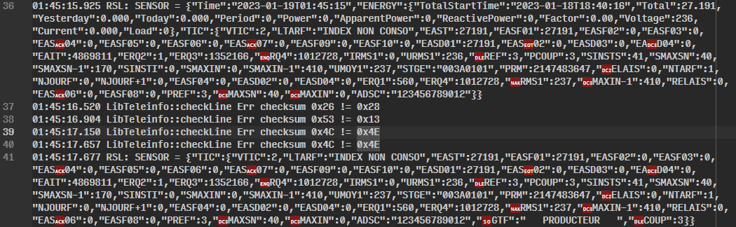

        I have the same problem, also with an injection meter for my solar panels! Here's my console dump in case it helps. The only thing I replaced with a dummy is the address of my linky:

        Not sure if it matters, but when I copied from the console into my editor (vscode) it highlighted some low ASCII chars - see the screenshot. They are included in the output pasted here as well.
        There's something wrong in the data for sure, when looking at the main Tasmota page the text I see for "Message 1" changes slightly. Here are ones I've seen so far:
        • PAS DE MSSAGE (\x05 in place of the missing char)
        • PAS DE MESSAE (\x07 in place of the missing char)
        • PAS DE MESSAGE (correct)
        Unfortunately my primary Linky for power consumption is in mode historique and the EDF people never reacted to my request to change it so I cannot test if it's the same problem there or only on the production linky... 😕
        Edit: I just realized that something truncated long lines from the output I posted above... here's one captured via usb/serial connection. Doesn't contain the ASCII garbage but the full data in case it's useful...

        02:04:07.676 RSL: SENSOR = {"TIC":{"ADSC":"12345679012","VTIC":2,"GTF":"   PRODUCTEUR   ","LTARF":"INDEX NON CONSO","EAST":27191,"EASF01":27191,"EAS02":0,"EASF04":0,"EASF05":0,"EASF06":0,"EAS07":0,"EASF09":0,"EASF10":0,"STGE":"003A0101","PRM":2147483647,"RELAIS":0,"NTARF":1,"NJOURF":0,"NJOURF+1":0,"EASF02":0,"EASF03":0,"EAS04":0,"EASF07":0,"EASF08":0,"EAS09":0,"EAD01":27191,"EASD02":0,"EASD03":0,"EAS04":0,"EAIT":4869811,"ERQ1":560,"ERQ2":1,"ERQ3":1352166,"ERQ4":1012741,"IRMS1":0,"URMS1":237,"PREF":3,"PCOUP":3,"SINSTS":41,"MAXSN":40,"SMAXSN-1":170,"SINSTI":0,"SMAXIN":0,"SMAXIN-1":410,"UMOY1":236,"EASD01":27191,"EASD04":0,"RMS1":237,"REF":3,"SMAXSN":40,"MAXIN-1":410,"ASF02":0,"MAXIN":0,"EAS08":0,"EAS03":0,"NGTF":"PRODUCTEUR","EAF01":27191,"SINTS":41,"SINTI":0}}
        02:04:07.742 LibTeleinfo::checkLine Err checksum 0x42 != 0x3A
        02:04:08.157 LibTeleinfo::checkLine Err checksum 0x23 != 0x25
        02:04:08.159 LibTeleinfo::checkLine Err checksum 0x27 != 0x07
        02:04:08.679 LibTeleinfo::checkLine Err checksum 0x53 != 0x55
        02:04:09.663 LibTeleinfo::checkLine Err checksum 0x35 != 0x39
        02:04:09.680 RSL: SENSOR = {"TIC":{"ADSC":"12345679012","VTIC":2,"GTF":"   PRODUCTEUR   ","LTARF":"INDEX NON CONSO","EAST":27191,"EASF01":27191,"EAS02":0,"EASF04":0,"EASF05":0,"EASF06":0,"EAS07":0,"EASF09":0,"EASF10":0,"STGE":"003A0101","PRM":2147483647,"RELAIS":0,"NTARF":1,"NJOURF":0,"NJOURF+1":0,"EASF02":0,"EASF03":0,"EAS04":0,"EASF07":0,"EASF08":0,"EAS09":0,"EAD01":27191,"EASD02":0,"EASD03":0,"EAS04":0,"EAIT":4869811,"ERQ1":560,"ERQ2":1,"ERQ3":1352166,"ERQ4":1012742,"IRMS1":0,"URMS1":237,"PREF":3,"PCOUP":3,"SINSTS":41,"MAXSN":40,"SMAXSN-1":170,"SINSTI":0,"SMAXIN":0,"SMAXIN-1":410,"UMOY1":236,"EASD01":27191,"EASD04":0,"RMS1":237,"REF":3,"SMAXSN":40,"MAXIN-1":410,"ASF02":0,"MAXIN":0,"EAS08":0,"EAS03":0,"NGTF":"PRODUCTEUR","EAF01":27191,"SINTS":41,"SINTI":0,"EAS03":0}}

                            • Nicolas FovetN Offline
                              Nicolas Fovet @Charles
                              @Charles merci pour ta réactivité 😉
                              Je suis dans un lotissement en campagne.
                              Voici ce que j'obtiens :
                              sts Jul 29 2019 12:21:46
                              rst:0x1 (POWERON_RESET),boot:0x13 (SPI_FAST_FLASH_BOOT)
                              configsip: 271414342, SPIWP:0xee
                              clk_drv:0x00,q_drv:0x00,d_drv:0x00,cs0_drv:0x00,hd_drv:0x00,wp_drv:0x00
                              mode:DIO, clock div:1
                              load:0x3fff0030,len:1184
                              load:0x40078000,storique
                              TIC RX=GPIO8  Mode:Standard
                              <TAB><INTERRUPT><TAB><TAB><TAB><TAB><TAB><TAB><TAB><INTERRUPT><TAB><INTERRUPT><INTERRUPT><TAB><TAB><TAB><TAB><TAB><TAB><TAB><TAB><TAB><INTERRUPT><TAB><INTERRUPT><TAB><TAB><TAB><TAB><TAB><TAB><TAB><TAB><TAB><TAB><TAB><TAB><TAB><TAB><TAB><TAB><TAB><TAB><TAB><TAB><TAB><TAB><TAB><STX><STX><TAB><TAB><TAB><TAB><TAB><TAB><TAB><TAB><TAB><TAB><TAB><TAB><TAB><TAB><TAB><INTERRUPT><TAB><TAB><TAB><TAB><TAB><TAB><TAB><INTERRUPT><TAB><INTERRUPT><TAB><TAB><ETX><STX><TAB><INTERRUPT><TAB><TAB><TAB><TAB><TAB><INTERRUPT><TAB><INTERRUPT><ETX><TAB><TAB><TAB><TAB><TAB><TAB><INTERRUPT><INTERRUPT><TAB><INTERRUPT><TAB><TAB><TAB><TAB><TAB><TAB><TAB><INTERRUPT><INTERRUPT><TAB><INTERRUPT><TAB><TAB><TAB><TAB><TAB><TAB><TAB><INTERRUPT><TAB><INTERRUPT><INTERRUPT><TAB><TAB><TAB><TAB><TAB><TAB><TAB><TAB><TAB><INTERRUPT><TAB><INTERRUPT><TAB><TAB><TAB><TAB><TAB><TAB><TAB><TAB><TAB><TAB><TAB><TAB><TAB><TAB><TAB><TAB><TAB><TAB><TAB><TAB><TAB><TAB><TAB><TAB><TAB><TAB><STX><STX><TAB><TAB><TAB><TAB><TAB><TAB><TAB><TAB><TAB><TAB><TAB><TAB><TAB><TAB><TAB><INTERRUPT><TAB><TAB><TAB><TAB><TAB><TAB><TAB><INTERRUPT><TAB><INTERRUPT><TAB><TAB><ETX><STX><TAB><INTERRUPT><STX><INTERRUPT><INTERRUPT><TAB><TAB><INTERRUPT><TAB><TAB><TAB><TAB><TAB><INTERRUPT><INTERRUPT><TAB><INTERRUPT><TAB><TAB><TAB><TAB><TAB><TAB><TAB><INTERRUPT><INTERRUPT><INTERRUPT><TAB><INTERRUPT><TAB><TAB><TAB><TAB><TAB><TAB><TAB><INTERRUPT><TAB><INTERRUPT><INTERRUPT><TAB><TAB><TAB><TAB><TAB><TAB><TAB><INTERRUPT><TAB><TAB><TAB><TAB><TAB><TAB><TAB><TAB><TAB><TAB><TAB><TAB><TAB><TAB><TAB><TAB><TAB><TAB><TAB><TAB><TAB><TAB><TAB><TAB><TAB><TAB><TAB><TAB><TAB><ETX><ETX><TAB><TAB><TAB><TAB><TAB><TAB><TAB><TAB><TAB><TAB><TAB><INTERRUPT><INTERRUPT><TAB><TAB><TAB><TAB><TAB><TAB><TAB><TAB><TAB><TAB><TAB><TAB><INTERRUPT><TAB><INTERRUPT><TAB><TAB><ETX><STX><TAB><INTERRUPT><STX><INTERRUPT><TAB><TAB><INTERRUPT><TAB><TAB><TAB><TAB><TAB><INTERRUPT><TAB><INTERRUPT><INTERRUPT><TAB><TAB><TAB><TAB><TAB><TAB><TAB><INTERRUPT><TAB><INTERRUPT><INTERRUPT><TAB><TAB><INTERRUPT><TAB><TAB><TAB><TAB><TAB><TAB><INTERRUPT><INTERRUPT><TAB><INTERRUPT><TAB><TAB><TAB><TAB><TAB><TAB><TAB><TAB><INTERRUPT><TAB><TAB><TAB><TAB><TAB><TAB><TAB><TAB><TAB><TAB><TAB><TAB><TAB><TAB><TAB><TAB><TAB><TAB><TAB><TAB><TAB><TAB><TAB><TAB><TAB><TAB><TAB><TAB><TAB><TAB><TAB><TAB><TAB><TAB><TAB><TAB><INTERRUPT><TAB><TAB><TAB><TAB><TAB><TAB><TAB><TAB><TAB><TAB><TAB><TAB><TAB><INTERRUPT><TAB><TAB><ETX><STX><TAB><INTERRUPT><ETX><TAB><TAB><INTERRUPT><TAB><TAB><TAB><TAB><TAB><TAB><STX><INTERRUPT><TAB><INTERRUPT><INTERRUPT><TAB><TAB><TAB><TAB><TAB><TAB><TAB><INTERRUPT><TAB><INTERRUPT><INTERRUPT><TAB><TAB><INTERRUPT><TAB><TAB><TAB><TAB><TAB><TAB><INTERRUPT><INTERRUPT><TAB><TAB><INTERRUPT><TAB><TAB><TAB><TAB><TAB><TAB><TAB><INTERRUPT><TAB><INTERRUPT><TAB><TAB><TAB><TAB><TAB><TAB><TAB><TAB><TAB><TAB><TAB><TAB><TAB><TAB><TAB><INTERRUPT><TAB><TAB><TAB><TAB><TAB><TAB><TAB><TAB><TAB><TAB><TAB><TAB><TAB><TAB><TAB><STX><STX><TAB><TAB><TAB><INTERRUPT><TAB><INTERRUPT><TAB><TAB><INTERRUPT><INTERRUPT><TAB><INTERRUPT><TAB><TAB><INTERRUPT><TAB><INTERRUPT><TAB><INTERRUPT><TAB><TAB><ETX><STX><STX><TAB><INTERRUPT><TAB><ETX><TAB><TAB><INTERRUPT><TAB><TAB><TAB><TAB><TAB><TAB><STX><INTERRUPT><TAB><INTERRUPT><INTERRUPT><TAB><TAB><TAB><TAB><TAB><TAB><TAB><INTERRUPT><INTERRUPT><TAB><INTERRUPT><INTERRUPT><TAB><TAB><TAB><TAB><TAB><TAB><TAB><TAB><INTERRUPT><INTERRUPT><TAB><TAB><INTERRUPT><TAB><TAB><TAB><TAB><TAB><STX><TAB><INTERRUPT><TAB><INTERRUPT><TAB><TAB><TAB><TAB><TAB><TAB><TAB><TAB><TAB><TAB><TAB><TAB><TAB><TAB><TAB><INTERRUPT><TAB><TAB><TAB><TAB><TAB><TAB><TAB><TAB><TAB><TAB><TAB><TAB><TAB><TAB><TAB><STX><STX><TAB><TAB><TAB><TAB><TAB><TAB><TAB><INTERRUPT><INTERRUPT><TAB><TAB><TAB><TAB><TAB><TAB><TAB><TAB><INTERRUPT><INTERRUPT><INTERRUPT><INTERRUPT><INTERRUPT><TAB><INTERRUPT><STX><STX><TAB><INTERRUPT><STX><INTERRUPT><INTERRUPT><TAB><TAB><INTERRUPT><TAB><TAB><TAB><TAB><INTERRUPT><INTERRUPT><TAB><INTERRUPT><TAB><TAB><TAB><TAB><TAB><TAB><TAB><INTERRUPT><INTERRUPT><INTERRUPT><TAB><INTERRUPT><TAB><TAB><TAB><TAB><TAB><TAB><TAB><INTERRUPT><TAB><INTERRUPT><INTERRUPT><TAB><TAB><TAB><TAB><TAB><TAB><TAB><INTERRUPT><TAB><TAB><TAB><TAB><TAB><TAB><TAB><TAB><TAB><TAB><TAB><TAB><TAB><TAB><TAB><TAB><TAB><TAB><TAB><TAB><TAB><TAB><TAB><TAB><TAB><TAB><TAB><TAB><TAB><TAB><TAB><TAB><TAB><TAB><TAB><TAB><TAB><TAB><TAB><TAB><TAB><TAB><TAB><TAB><TAB><TAB><TAB><TAB><INTERRUPT><INTERRUPT><INTERRUPT><TAB><INTERRUPT><STX><STX><TAB><INTERRUPT><STX><TAB><TAB><INTERRUPT><TAB><TAB><TAB><TAB><TAB><TAB><STX><INTERRUPT><TAB><INTERRUPT><INTERRUPT><TAB><TAB><TAB><TAB><TAB><TAB><TAB><TAB><TAB><INTERRUPT><TAB><INTERRUPT><INTERRUPT><TAB><TAB><INTERRUPT><TAB><TAB><TAB><TAB><TAB><TAB><TAB><INTERRUPT><INTERRUPT><TAB><INTERRUPT><TAB><TAB><TAB><TAB><TAB><TAB><TAB><TAB><INTERRUPT><TAB><TAB><TAB><TAB><TAB><TAB><TAB><TAB><TAB><TAB><TAB><TAB><TAB><TAB><TAB><TAB><TAB><TAB><TAB><TAB><TAB><TAB><TAB><TAB><TAB><TAB><TAB><TAB><TAB><TAB><TAB><TAB><TAB><TAB><TAB><INTERRUPT><INTERRUPT><TAB><TAB><TAB><TAB><TAB><TAB><TAB><TAB><TAB><TAB><TAB><TAB><TAB><INTERRUPT><TAB><TAB><ETX><INTERRUPT><ETX><TAB><TAB><TAB><TAB><TAB><TAB><TAB><TAB><INTERRUPT><STX><INTERRUPT><TAB><INTERRUPT><TAB><INTERRUPT><TAB><TAB><TAB><TAB><TAB><TAB><STX><TAB><INTERRUPT><INTERRUPT><TAB><TAB><INTERRUPT><TAB><TAB><TAB><TAB><TAB><TAB><INTERRUPT><INTERRUPT><TAB><TAB><INTERRUPT><TAB><TAB><TAB><TAB><TAB><TAB><TAB><INTERRUPT><INTERRUPT><TAB><TAB><TAB><TAB><TAB><TAB><TAB><TAB><TAB><TAB><TAB><TAB><INTERRUPT><INTERRUPT><TAB><TAB><STX><TAB><TAB><TAB><TAB><TAB><TAB><TAB><TAB><TAB><TAB><TAB><TAB><TAB><TAB><TAB><TAB><TAB><TAB><TAB><TAB><TAB><ETX>
                              {« _UPTIME »:49}
                              <ETX><TAB>-1<TAB>030121150000<TAB>01740<TAB>J
                              UMOY1<TAB>H230121155000<TAB>024
                              STG<INTERRUPT><INTERRUPT><TAB><TAB><INTERRUPT><INTERRUPT><INTERRUPT><TAB><TAB><INTERRUPT><TAB><INTERRUPT><INTERRUPT><TAB><INTERRUPT><TAB><ETX><STX><TAB><TAB><TAB><TAB><TAB><INTERRUPT><INTERRUPT><ETX><TAB><INTERRUPT><TAB><TAB><TAB><TAB><TAB><INTERRUPT><TAB><INTERRUPT><INTERRUPT><TAB><TAB><TAB><TAB><TAB><TAB><TAB><TAB><INTERRUPT><INTERRUPT><TAB><TAB><INTERRUPT><TAB><TAB><TAB><TAB><TAB><TAB><TAB><INTERRUPT><INTERRUPT><TAB><INTERRUPT><TAB><TAB><TAB><TAB><TAB><TAB><TAB><TAB><INTERRUPT><TAB><TAB><TAB><TAB><TAB><TAB><TAB><TAB><ETX><TAB><TAB><TAB><TAB><TAB><TAB><TAB><TAB><TAB><TAB><TAB><TAB><TAB><TAB><TAB><TAB><TAB><TAB><ETX><ETX><TAB><TAB><TAB><TAB><TAB><TAB><TAB><TAB><TAB><TAB><TAB><TAB><TAB><TAB><TAB><TAB><TAB><TAB><TAB><TAB><TAB><INTERRUPT><TAB><INTERRUPT><TAB><TAB><ETX><STX><TAB><TAB><TAB><TAB><TAB><INTERRUPT><INTERRUPT><ETX><TAB><INTERRUPT><TAB><TAB><TAB><TAB><TAB><INTERRUPT><TAB><INTERRUPT><INTERRUPT><TAB><TAB><TAB><TAB><TAB><TAB><TAB><TAB><INTERRUPT><INTERRUPT><TAB><TAB><INTERRUPT><TAB><TAB><TAB><TAB><TAB><TAB><TAB><TAB><TAB><INTERRUPT><INTERRUPT><TAB><TAB><TAB><TAB><TAB><TAB><TAB><TAB><TAB><TAB><TAB><TAB><INTERRUPT><INTERRUPT><TAB><TAB><STX><TAB><TAB><TAB><TAB><TAB><TAB><TAB><TAB><TAB><TAB><TAB><TAB><TAB><TAB><TAB><TAB><TAB><TAB><STX><STX><TAB><TAB><TAB><TAB><TAB><TAB><TAB><TAB><TAB><TAB><TAB><TAB><INTERRUPT><TAB><TAB><INTERRUPT><TAB><TAB><INTERRUPT><TAB><TAB><INTERRUPT><TAB><TAB><TAB><INTERRUPT><TAB><INTERRUPT><TAB><TAB><ETX><STX><TAB><TAB><TAB><TAB><TAB><INTERRUPT><INTERRUPT><ETX><TAB><INTERRUPT><TAB><TAB><TAB><TAB><TAB><INTERRUPT><TAB><INTERRUPT><INTERRUPT><TAB><TAB><TAB><TAB><TAB><TAB><TAB><TAB><INTERRUPT><INTERRUPT><TAB><TAB><INTERRUPT><TAB><TAB><TAB><TAB><TAB><TAB><INTERRUPT><INTERRUPT><TAB><INTERRUPT><TAB><TAB><TAB><TAB><TAB><TAB><TAB><TAB><INTERRUPT><TAB><TAB><TAB><TAB><TAB><TAB><TAB><TAB><ETX><TAB><TAB><TAB><TAB><TAB><TAB><TAB><TAB><TAB><TAB><TAB><TAB><TAB><TAB><TAB><TAB><TAB><ETX><ETX><TAB><TAB><TAB><TAB><TAB><TAB><TAB><TAB><TAB><TAB><INTERRUPT><TAB><TAB><TAB><TAB><TAB><TAB><TAB><TAB><TAB><TAB><TAB><TAB><INTERRUPT><TAB><INTERRUPT><TAB><TAB><ETX><TAB><TAB><TAB><TAB><TAB><TAB><INTERRUPT><STX><INTERRUPT><TAB><INTERRUPT><INTERRUPT><INTERRUPT><ETX><TAB><TAB><TAB><TAB><TAB><TAB><TAB><TAB><INTERRUPT><INTERRUPT><INTERRUPT><TAB><INTERRUPT><TAB><TAB><TAB><TAB><TAB><TAB><TAB><INTERRUPT><TAB><INTERRUPT><INTERRUPT><TAB><TAB><TAB><TAB><TAB><TAB><TAB><INTERRUPT><TAB><INTERRUPT><TAB><TAB><TAB><TAB><TAB><TAB><TAB><TAB><TAB><INTERRUPT><INTERRUPT><INTERRUPT><STX><TAB><TAB><INTERRUPT><TAB><TAB><TAB><TAB><TAB><TAB><TAB><TAB><TAB><TAB><TAB><TAB><TAB><ETX><ETX><TAB><TAB><TAB><TAB><TAB><INTERRUPT><TAB><TAB><INTERRUPT><TAB><TAB><INTERRUPT><TAB><INTERRUPT><TAB><INTERRUPT><TAB><TAB><INTERRUPT><TAB><TAB><INTERRUPT><TAB><INTERRUPT><TAB><INTERRUPT><TAB><TAB><ETX><TAB><TAB><TAB><TAB><TAB><TAB><INTERRUPT><STX><TAB><INTERRUPT><TAB><TAB><INTERRUPT><TAB><TAB><TAB><TAB><TAB><TAB><STX><INTERRUPT><INTERRUPT><TAB><INTERRUPT><TAB><TAB><TAB><TAB><TAB><TAB><TAB><INTERRUPT><INTERRUPT><TAB><INTERRUPT><INTERRUPT><TAB><TAB><TAB><TAB><TAB><TAB><TAB><INTERRUPT><TAB><INTERRUPT><INTERRUPT><TAB><TAB><TAB><TAB><TAB><TAB><TAB><TAB><TAB><TAB><TAB><TAB><TAB><TAB><INTERRUPT><TAB><TAB><ETX><TAB><TAB><TAB><TAB><TAB><TAB><TAB><TAB><TAB><TAB><TAB><TAB><TAB><TAB><TAB><TAB><TAB><TAB><TAB><TAB><STX><STX><TAB><TAB><TAB><TAB><TAB><TAB><TAB><TAB><TAB><TAB><TAB><TAB><TAB><TAB><TAB><INTERRUPT><TAB><TAB><TAB><TAB><TAB><TAB><TAB><INTERRUPT><TAB><INTERRUPT><INTERRUPT><TAB><TAB><ETX><STX><TAB><TAB><TAB><TAB><TAB><TAB><TAB><INTERRUPT><INTERRUPT><ETX><TAB><TAB><TAB><TAB><TAB><TAB><INTERRUPT><INTERRUPT><TAB><INTERRUPT><TAB><TAB><TAB><TAB><TAB><TAB><TAB><INTERRUPT><INTERRUPT><TAB><INTERRUPT><TAB><TAB><TAB><TAB><TAB><TAB><TAB><INTERRUPT><TAB><INTERRUPT><INTERRUPT><TAB><TAB><TAB><TAB><TAB><TAB><TAB><TAB><TAB><INTERRUPT><TAB><INTERRUPT><TAB><TAB><TAB><TAB><TAB><TAB><TAB><TAB><TAB><TAB><TAB><TAB><TAB><TAB><TAB><TAB><TAB><TAB><TAB><TAB><TAB><TAB><TAB><ETX><ETX><TAB><TAB><TAB><TAB><TAB><TAB><TAB><TAB><TAB><TAB><TAB><INTERRUPT><INTERRUPT><TAB><TAB><TAB><TAB><TAB><TAB><TAB><TAB><TAB><TAB><TAB><TAB><INTERRUPT><TAB><INTERRUPT><TAB><TAB><ETX><STX><TAB><TAB><TAB><TAB><TAB><TAB><TAB><INTERRUPT><INTERRUPT><ETX><TAB><TAB><TAB><TAB><TAB><TAB><INTERRUPT><INTERRUPT><TAB><INTERRUPT><TAB><TAB><TAB><TAB><TAB><TAB><TAB><INTERRUPT><INTERRUPT><TAB><INTERRUPT><TAB><TAB><TAB><TAB><TAB><TAB><TAB><INTERRUPT><TAB><INTERRUPT><INTERRUPT><TAB><TAB><TAB><TAB><TAB><TAB><TAB><TAB><TAB><INTERRUPT><TAB><INTERRUPT><TAB><TAB><TAB><TAB><TAB><TAB><TAB><TAB><TAB><TAB><TAB><TAB><TAB><TAB><TAB><TAB><TAB><TAB><TAB><TAB><TAB><TAB><TAB><ETX><ETX><TAB><TAB><TAB><TAB><TAB><TAB><TAB><TAB><TAB><TAB><TAB><INTERRUPT><INTERRUPT><TAB><TAB><TAB><TAB><TAB><TAB><TAB><TAB><TAB><TAB><TAB><TAB><INTERRUPT><TAB><INTERRUPT><TAB><TAB><ETX><STX><TAB><TAB><TAB><TAB><TAB><INTERRUPT><INTERRUPT><ETX><TAB><INTERRUPT><TAB><TAB><TAB><TAB><TAB><INTERRUPT><TAB><INTERRUPT><INTERRUPT><TAB><TAB><TAB><TAB><TAB><TAB><TAB><TAB><INTERRUPT><INTERRUPT><TAB><TAB><INTERRUPT><TAB><TAB><TAB><TAB><TAB><TAB><TAB><INTERRUPT><INTERRUPT><TAB><INTERRUPT><TAB><TAB><TAB><TAB><TAB><TAB><TAB><TAB><INTERRUPT><TAB><TAB><TAB><TAB><TAB><TAB><TAB><TAB><ETX><TAB><TAB><TAB><TAB><TAB><TAB><TAB><TAB><TAB><TAB><TAB><TAB><TAB><TAB><TAB><TAB><TAB><ETX><ETX><TAB><TAB><TAB><TAB><TAB><TAB><TAB><TAB><TAB><TAB><INTERRUPT><TAB><TAB><TAB><TAB><TAB><TAB><TAB><TAB><TAB><TAB><INTERRUPT><TAB><TAB><INTERRUPT><TAB><TAB><ETX><STX><TAB><INTERRUPT><STX><INTERRUPT><TAB><TAB><INTERRUPT><TAB><TAB><TAB><TAB><TAB><INTERRUPT><TAB><INTERRUPT><INTERRUPT><TAB><TAB><TAB><TAB><TAB><TAB><TAB><INTERRUPT><TAB><INTERRUPT><INTERRUPT><TAB><TAB><INTERRUPT><TAB><TAB><TAB><TAB><TAB><TAB><INTERRUPT><INTERRUPT><TAB><INTERRUPT><TAB><TAB><TAB><TAB><TAB><TAB><TAB><TAB><INTERRUPT><TAB><TAB><TAB><TAB><TAB><TAB><TAB><TAB><TAB><TAB><TAB><TAB><TAB><TAB><TAB><TAB><TAB><TAB><TAB><TAB><TAB><TAB><TAB><TAB><TAB><TAB><TAB><TAB><TAB><TAB><TAB><TAB><TAB><TAB><TAB><INTERRUPT><TAB><TAB><TAB><TAB><TAB><TAB><TAB><TAB><TAB><TAB><TAB><INTERRUPT><TAB><INTERRUPT><TAB><TAB><ETX><STX><TAB><INTERRUPT><STX><INTERRUPT><TAB><TAB><INTERRUPT><TAB><TAB><TAB><TAB><TAB><INTERRUPT><TAB><INTERRUPT><INTERRUPT><TAB><TAB><TAB><TAB><TAB><TAB><TAB><INTERRUPT><TAB><INTERRUPT><INTERRUPT><TAB><TAB><INTERRUPT><TAB><TAB><TAB><TAB><TAB><TAB><INTERRUPT><INTERRUPT><TAB><TAB><INTERRUPT><TAB><TAB><TAB><TAB><TAB><TAB><TAB><TAB><INTERRUPT><TAB><TAB><TAB><TAB><TAB><TAB><TAB><TAB><TAB><TAB><TAB><TAB><TAB><TAB><TAB><TAB><TAB><TAB><TAB><TAB><TAB><TAB><TAB><TAB><TAB><TAB><TAB><TAB><TAB><TAB><TAB><TAB><TAB><TAB><TAB><INTERRUPT><TAB><TAB><TAB><TAB><TAB><TAB><TAB><TAB><TAB><TAB><TAB><TAB><TAB><INTERRUPT><TAB><TAB><ETX><STX><TAB><INTERRUPT><STX><INTERRUPT><TAB><TAB><INTERRUPT><TAB><TAB><TAB><TAB><TAB><INTERRUPT><TAB><INTERRUPT><INTERRUPT><TAB><TAB><TAB><TAB><TAB><TAB><TAB><INTERRUPT><TAB><INTERRUPT><INTERRUPT><TAB><TAB><INTERRUPT><TAB><TAB><TAB><TAB><TAB><TAB><INTERRUPT><INTERRUPT><TAB><TAB><INTERRUPT><TAB><TAB><TAB><TAB><TAB><TAB><TAB><TAB><INTERRUPT><TAB><TAB><TAB><TAB><TAB><TAB><TAB><TAB><TAB><TAB><TAB><TAB><TAB><TAB><TAB><TAB><TAB><TAB><TAB><TAB><TAB><TAB><TAB><TAB><TAB><TAB><TAB><TAB><TAB><TAB><TAB><TAB><TAB><TAB><TAB><TAB><INTERRUPT><TAB><TAB><TAB><TAB><TAB><TAB><TAB><TAB><TAB><TAB><TAB><TAB><TAB><INTERRUPT><TAB><TAB><ETX><STX><TAB><TAB><TAB><TAB><TAB><INTERRUPT><INTERRUPT><ETX><TAB><INTERRUPT><TAB><TAB><TAB><TAB><TAB><TAB><INTERRUPT><INTERRUPT><TAB><TAB><INTERRUPT><TAB><TAB><TAB><TAB><TAB><INTERRUPT><INTERRUPT><TAB><INTERRUPT><TAB><TAB><TAB><TAB><TAB><TAB><TAB><INTERRUPT><INTERRUPT><TAB><INTERRUPT><TAB><TAB><TAB><TAB><TAB><TAB><TAB><TAB><TAB><TAB><TAB><TAB><INTERRUPT><INTERRUPT><TAB><STX><TAB><TAB><TAB><TAB><TAB><TAB><TAB><TAB><TAB><TAB><TAB><TAB><TAB><TAB><TAB><TAB><STX><STX><TAB><TAB><ETX>CAIN-1<TAB>H230121150000<TAB>01740<TAB>J
                              UMOY1<TAB>H230120044000025<TAB>,
                              <INTERRUPT><TAB><TAB><TAB><TAB><INTERRUPT><TAB><INTERRUPT><TAB><TAB><INTERRUPT><TAB><TAB><INTERRUPT><TAB><TAB><TAB><INTERRUPT><INTERRUPT><TAB><INTERRUPT><TAB><TAB><ETX><STX><TAB><TAB><TAB><TAB><TAB><INTERRUPT><INTERRUPT><ETX><TAB><INTERRUPT><TAB><TAB><TAB><TAB><TAB><TAB><TAB><INTERRUPT><INTERRUPT><TAB><TAB><INTERRUPT><TAB><TAB><TAB><TAB><TAB><INTERRUPT><INTERRUPT><TAB><INTERRUPT><TAB><TAB><TAB><TAB><TAB><TAB><TAB><INTERRUPT><INTERRUPT><TAB><INTERRUPT><TAB><TAB><TAB><TAB><TAB><TAB><TAB><TAB><INTERRUPT><TAB><TAB><TAB><TAB><TAB><INTERRUPT><TAB><TAB><ETX><TAB><TAB><TAB><TAB><TAB><TAB><TAB><TAB><TAB><TAB><TAB><TAB><TAB><TAB><TAB><TAB><STX><STX><TAB><TAB><ETX>CAIN-1<TAB>H230121150000<TAB>01740<TAB>J
                              <INTERRUPT><TAB><TAB><TAB><TAB><TAB><INTERRUPT><TAB><TAB><INTERRUPT><TAB><TAB><INTERRUPT><TAB><TAB><INTERRUPT><TAB><TAB><TAB><INTERRUPT><INTERRUPT><TAB><INTERRUPT><TAB><TAB><ETX><STX><TAB><INTERRUPT><TAB><TAB><TAB><INTERRUPT><TAB><TAB><TAB><TAB><TAB><TAB><INTERRUPT><INTERRUPT><TAB><TAB><INTERRUPT><TAB><TAB><TAB><TAB><TAB><INTERRUPT><TAB><INTERRUPT><INTERRUPT><TAB><TAB><INTERRUPT><TAB><TAB><TAB><TAB><TAB><TAB><TAB><INTERRUPT><INTERRUPT><TAB><INTERRUPT><TAB><TAB><TAB><TAB><TAB><TAB><TAB><TAB><INTERRUPT><TAB><TAB><TAB><TAB><TAB><TAB><TAB><TAB><TAB><TAB><TAB><TAB><TAB><TAB><TAB><TAB><TAB><TAB><TAB><TAB><TAB><TAB><TAB><TAB><TAB><TAB><TAB><TAB><TAB><TAB><TAB><TAB><TAB><TAB><INTERRUPT><INTERRUPT><TAB><TAB><TAB><TAB><TAB><TAB><TAB><TAB><TAB><TAB><TAB><TAB><INTERRUPT><TAB><INTERRUPT><TAB><TAB><ETX><STX><TAB><INTERRUPT><TAB><TAB><TAB><INTERRUPT><TAB><TAB><TAB><TAB><TAB><TAB><INTERRUPT><INTERRUPT><TAB><TAB><INTERRUPT><TAB><TAB><TAB><TAB><TAB><INTERRUPT><TAB><INTERRUPT><INTERRUPT><TAB><TAB><INTERRUPT><TAB><TAB><TAB><TAB><TAB><TAB><TAB><INTERRUPT><INTERRUPT><TAB><INTERRUPT><TAB><TAB><TAB><TAB><TAB><TAB><TAB><TAB><INTERRUPT><TAB><TAB><TAB><TAB><TAB><TAB><TAB><TAB><TAB><TAB><TAB><TAB><TAB><TAB><TAB><TAB><TAB><TAB><TAB><TAB><TAB><TAB><TAB><TAB><TAB><TAB><TAB><TAB><TAB><TAB><TAB><TAB><TAB><TAB><TAB><TAB><TAB><TAB><TAB><TAB><TAB><TAB><TAB><TAB><INTERRUPT><TAB><INTERRUPT><TAB><TAB><ETX><STX><TAB><INTERRUPT><TAB><TAB><TAB><INTERRUPT><TAB><TAB><TAB><TAB><TAB><TAB><INTERRUPT><INTERRUPT><TAB><TAB><INTERRUPT><TAB><TAB><TAB><TAB><TAB><INTERRUPT><TAB><INTERRUPT><INTERRUPT><TAB><TAB><INTERRUPT><TAB><TAB><TAB><TAB><TAB><TAB><TAB><INTERRUPT><INTERRUPT><TAB><INTERRUPT><TAB><TAB><TAB><TAB><TAB><TAB><TAB><TAB><INTERRUPT><TAB><TAB><TAB><TAB><TAB><TAB><TAB><TAB><TAB><TAB><TAB><TAB><TAB><TAB><TAB><TAB><TAB><TAB><TAB><TAB><TAB><TAB><TAB><TAB><TAB><TAB><TAB><TAB><TAB><TAB><TAB><TAB><TAB><TAB><INTERRUPT><INTERRUPT><TAB><TAB><TAB><TAB><TAB><TAB><TAB><TAB><TAB><TAB><TAB><TAB><TAB><INTERRUPT><TAB><TAB><ETX><STX><TAB><INTERRUPT><INTERRUPT><TAB><TAB><INTERRUPT><TAB><TAB><TAB><TAB><TAB><INTERRUPT><TAB><INTERRUPT><INTERRUPT><TAB><TAB><TAB><TAB><TAB><TAB><TAB><INTERRUPT><TAB><INTERRUPT><INTERRUPT><TAB><TAB><INTERRUPT><TAB><TAB><TAB><TAB><TAB><TAB><TAB><INTERRUPT><INTERRUPT><TAB><INTERRUPT><TAB><TAB><TAB><TAB><TAB><TAB><TAB><TAB><INTERRUPT><TAB><TAB><TAB><TAB><TAB><TAB><TAB><TAB><TAB><TAB><TAB><TAB><TAB><TAB><TAB><TAB><TAB><TAB><TAB><TAB><TAB><TAB><TAB><TAB><TAB><TAB><TAB><TAB><TAB><TAB><TAB><TAB><TAB><TAB><INTERRUPT><INTERRUPT><TAB><TAB><TAB><TAB><TAB><TAB><TAB><TAB><TAB><TAB><TAB><TAB><TAB><INTERRUPT><TAB><TAB><ETX><STX><TAB><INTERRUPT><STX><TAB><TAB><INTERRUPT><TAB><TAB><TAB><TAB><TAB><TAB><STX><INTERRUPT><TAB><INTERRUPT><INTERRUPT><TAB><TAB><TAB><TAB><TAB><TAB><TAB><INTERRUPT><TAB><INTERRUPT><INTERRUPT><TAB><TAB><INTERRUPT><TAB><TAB><TAB><TAB><TAB><INTERRUPT><INTERRUPT><TAB><INTERRUPT><TAB><TAB><TAB><TAB><TAB><TAB><TAB><INTERRUPT><TAB><INTERRUPT><TAB><TAB><TAB><TAB><TAB><TAB><TAB><TAB><TAB><TAB><TAB><TAB><TAB><TAB><TAB><INTERRUPT><TAB><TAB><TAB><TAB><TAB><TAB><TAB><TAB><TAB><TAB><TAB><TAB><TAB><ETX><ETX><TAB><TAB><TAB><TAB><TAB><TAB><TAB><TAB><TAB><TAB><TAB><TAB><TAB><TAB><TAB><TAB><TAB><TAB><TAB><TAB><TAB><INTERRUPT><TAB><TAB><INTERRUPT><TAB><TAB><ETX><STX><TAB><INTERRUPT><TAB><TAB><TAB><TAB><INTERRUPT><TAB><INTERRUPT><TAB><TAB><TAB><TAB><TAB><INTERRUPT><INTERRUPT><TAB><TAB><INTERRUPT><TAB><TAB><TAB><TAB><TAB><INTERRUPT><TAB><INTERRUPT><INTERRUPT><TAB><INTERRUPT><TAB><TAB><TAB><TAB><TAB><TAB><TAB><INTERRUPT><INTERRUPT><TAB><INTERRUPT><TAB><TAB><TAB><TAB><TAB><TAB><TAB><TAB><INTERRUPT><TAB><TAB><TAB><TAB><TAB><TAB><TAB><TAB><TAB><TAB><TAB><TAB><TAB><INTERRUPT><TAB><TAB><TAB><TAB><TAB><TAB><TAB><TAB><TAB><TAB><TAB><TAB><TAB><TAB><TAB><TAB><TAB><TAB><TAB><TAB><TAB><TAB><TAB><TAB><INTERRUPT><INTERRUPT><TAB><TAB><TAB><TAB><TAB><TAB><TAB><TAB><TAB><INTERRUPT><INTERRUPT><TAB><INTERRUPT><STX><STX><TAB><TAB><INTERRUPT><STX><TAB><INTERRUPT><INTERRUPT><TAB><TAB><TAB><TAB><TAB><TAB><TAB><INTERRUPT><INTERRUPT><TAB><TAB><INTERRUPT><TAB><TAB><TAB><TAB><TAB><INTERRUPT><TAB><INTERRUPT><INTERRUPT><TAB><TAB><INTERRUPT><TAB><TAB><TAB><TAB><TAB><TAB><TAB><INTERRUPT><INTERRUPT><TAB><INTERRUPT><TAB><TAB><TAB><TAB><TAB><TAB><TAB><TAB><INTERRUPT><TAB><TAB><TAB><TAB><TAB><TAB><TAB><TAB><TAB><TAB><TAB><TAB><TAB><TAB><TAB><TAB><TAB><TAB><TAB><TAB><TAB><TAB><TAB><TAB><TAB><TAB><TAB><TAB><TAB><TAB><TAB><ETX><ETX><TAB><TAB><TAB><TAB><TAB><TAB><TAB><TAB><TAB><TAB><TAB><TAB><TAB><TAB><TAB><TAB><TAB><TAB><TAB><TAB><TAB><TAB><INTERRUPT><TAB><INTERRUPT><TAB><TAB><ETX><STX><TAB><TAB><INTERRUPT><STX><TAB><INTERRUPT><INTERRUPT><TAB><TAB><TAB><TAB><TAB><TAB><TAB><INTERRUPT><INTERRUPT><TAB><TAB><TAB><TAB><TAB><TAB><TAB><INTERRUPT><TAB><INTERRUPT><INTERRUPT><TAB><TAB><INTERRUPT><TAB><TAB><TAB><TAB><TAB><TAB><INTERRUPT><TAB><TAB><TAB><TAB><TAB><TAB><TAB><INTERRUPT><INTERRUPT><TAB><TAB><TAB><TAB><TAB><TAB><TAB><TAB><TAB><TAB><TAB><TAB><TAB><INTERRUPT><INTERRUPT><INTERRUPT><TAB><TAB><TAB><TAB><TAB><INTERRUPT><TAB><TAB><TAB><TAB><TAB><TAB><TAB><TAB><TAB><TAB><TAB><TAB><TAB><TAB><TAB><STX><STX><TAB><TAB><TAB><TAB><TAB><TAB><TAB><INTERRUPT><INTERRUPT><TAB><TAB><TAB><TAB><TAB><TAB><TAB><TAB><INTERRUPT><INTERRUPT><INTERRUPT><INTERRUPT><TAB><INTERRUPT><STX><INTERRUPT><ETX><TAB><TAB><TAB><TAB><TAB><TAB><TAB><TAB><INTERRUPT><INTERRUPT><INTERRUPT><ETX><TAB><TAB><TAB><TAB><TAB><TAB><TAB><TAB><INTERRUPT><INTERRUPT><TAB><INTERRUPT><INTERRUPT><TAB><TAB><TAB><TAB><TAB><TAB><TAB><TAB><TAB><TAB><INTERRUPT><INTERRUPT><TAB><TAB><INTERRUPT><TAB><TAB><TAB><TAB><TAB><STX><TAB><INTERRUPT><TAB><INTERRUPT><TAB><TAB><TAB><TAB><TAB><TAB><TAB><TAB><TAB><TAB><TAB><TAB><TAB><TAB><TAB><INTERRUPT><TAB><TAB><TAB><TAB><TAB><TAB><TAB><TAB><TAB><TAB><TAB><ETX><ETX><TAB><TAB><TAB><TAB><TAB><TAB><TAB><TAB><TAB><TAB><INTERRUPT><TAB><TAB><TAB><TAB><TAB><TAB><TAB><TAB><TAB><TAB><TAB><INTERRUPT><TAB><INTERRUPT><TAB><TAB><ETX><TAB><TAB><TAB><TAB><TAB><TAB><TAB><TAB><INTERRUPT><STX><INTERRUPT><TAB><INTERRUPT><TAB><TAB><INTERRUPT><TAB><TAB><TAB><TAB><TAB><TAB><STX><INTERRUPT><TAB><INTERRUPT><INTERRUPT><TAB><TAB><TAB><TAB><TAB><TAB><TAB><INTERRUPT><TAB><INTERRUPT><INTERRUPT><TAB><TAB><TAB><TAB><TAB><TAB><TAB><TAB><INTERRUPT><INTERRUPT><TAB><TAB><TAB><TAB><TAB><TAB><TAB><TAB><TAB><TAB><TAB><TAB><TAB><TAB><INTERRUPT><INTERRUPT><TAB><TAB><ETX><TAB><TAB><TAB><TAB><TAB><TAB><TAB><TAB><TAB><TAB><TAB><TAB><TAB><TAB><TAB><TAB><TAB><TAB><TAB><TAB><TAB><TAB><TAB><ETX><ETX><TAB><TAB><TAB><TAB><TAB><INTERRUPT><TAB><INTERRUPT><TAB><TAB><INTERRUPT><INTERRUPT><TAB><INTERRUPT><TAB><TAB><INTERRUPT><TAB><INTERRUPT><TAB><INTERRUPT><TAB><TAB><ETX><INTERRUPT><ETX><TAB><TAB><TAB><TAB><TAB><TAB><TAB><TAB><INTERRUPT><INTERRUPT><INTERRUPT><ETX><TAB><TAB><TAB><TAB><TAB><TAB><TAB><TAB><INTERRUPT><INTERRUPT><TAB><INTERRUPT><INTERRUPT><TAB><TAB><TAB><TAB><TAB><TAB><TAB><INTERRUPT><TAB><INTERRUPT><INTERRUPT><TAB><TAB><INTERRUPT><INTERRUPT><TAB><TAB><INTERRUPT><TAB><TAB><TAB><TAB><TAB><STX><TAB><INTERRUPT><TAB><TAB><TAB><TAB><TAB><TAB><TAB><TAB><TAB><TAB><TAB><TAB><TAB><TAB><TAB><TAB><TAB><TAB><TAB><TAB><TAB><TAB><TAB><TAB><TAB><TAB><TAB><TAB><TAB><TAB><TAB><TAB><TAB><TAB><TAB><TAB><TAB><TAB><TAB><TAB><INTERRUPT><TAB><TAB><TAB><TAB><TAB><TAB><TAB><TAB><TAB><TAB><TAB><TAB><TAB><INTERRUPT><INTERRUPT><TAB><TAB><ETX><INTERRUPT><STX><TAB><TAB><ETX><TAB>02<TAB>J
                              <INTERRUPT><TAB><TAB><TAB><TAB><TAB><TAB><INTERRUPT><STX><TAB><INTERRUPT><TAB><TAB><INTERRUPT><TAB><TAB><TAB><TAB><TAB><INTERRUPT><TAB><INTERRUPT><INTERRUPT><TAB><INTERRUPT><TAB><TAB><TAB><TAB><TAB><TAB><TAB><INTERRUPT><INTERRUPT><TAB><INTERRUPT><TAB><TAB><TAB><TAB><TAB><TAB><TAB><STX><TAB><INTERRUPT><TAB><TAB><TAB><TAB><TAB><TAB><TAB><TAB><TAB><TAB><TAB><TAB><INTERRUPT><TAB><TAB><INTERRUPT><TAB><TAB><TAB><TAB><TAB><TAB><TAB><TAB><TAB><TAB><TAB><TAB><TAB><STX><STX><TAB><TAB><TAB><TAB><TAB><TAB><TAB><INTERRUPT><TAB><TAB><TAB><TAB><INTERRUPT><INTERRUPT><INTERRUPT><INTERRUPT><TAB><TAB><INTERRUPT><TAB><INTERRUPT><TAB><INTERRUPT><TAB><ETX><INTERRUPT><ETX><TAB><TAB><TAB><TAB><TAB><TAB><TAB><TAB><STX><INTERRUPT><INTERRUPT><INTERRUPT><ETX><TAB><TAB><TAB><TAB><TAB><TAB><STX><INTERRUPT><INTERRUPT><TAB><INTERRUPT><TAB><TAB><TAB><TAB><TAB><TAB><TAB><INTERRUPT><INTERRUPT><TAB><INTERRUPT><TAB><TAB><TAB><TAB><TAB><TAB><TAB><INTERRUPT><INTERRUPT><TAB><INTERRUPT><TAB><TAB><TAB><TAB><TAB><TAB><TAB><TAB><TAB><TAB><INTERRUPT><INTERRUPT><INTERRUPT><TAB><STX><TAB><TAB><TAB><INTERRUPT><TAB><TAB><TAB><TAB><TAB><TAB><TAB><TAB><TAB><TAB><TAB><TAB><TAB><ETX><ETX><TAB><TAB><TAB><TAB><INTERRUPT><TAB><TAB><TAB><TAB><INTERRUPT><TAB><INTERRUPT><TAB><TAB><INTERRUPT><TAB><TAB><INTERRUPT><TAB><TAB><TAB><INTERRUPT><TAB><INTERRUPT><TAB><TAB><ETX><INTERRUPT><STX><TAB><TAB><ETX><TAB>02<TAB>J
                              <INTERRUPT><TAB><TAB><TAB><TAB><TAB><TAB><INTERRUPT><INTERRUPT><STX><TAB><INTERRUPT><TAB><TAB><TAB><TAB><TAB><TAB><TAB><INTERRUPT><TAB><INTERRUPT><INTERRUPT><TAB><TAB><INTERRUPT><TAB><TAB><TAB><TAB><TAB><TAB><TAB><INTERRUPT><INTERRUPT><TAB><INTERRUPT><TAB><TAB><TAB><TAB><TAB><TAB><TAB><STX><INTERRUPT><TAB><INTERRUPT><TAB><TAB><TAB><TAB><TAB><TAB><TAB><TAB><TAB><TAB><TAB><INTERRUPT><TAB><INTERRUPT><TAB><TAB><TAB><TAB><TAB><TAB><TAB><TAB><TAB><TAB><TAB><STX><TAB><TAB><TAB><TAB><TAB><TAB><TAB><TAB><INTERRUPT><INTERRUPT><TAB><TAB><TAB><TAB><TAB><TAB><TAB><TAB><TAB><INTERRUPT><INTERRUPT><TAB><INTERRUPT><STX><INTERRUPT><ETX><TAB><TAB><TAB><TAB><TAB><TAB><TAB><TAB><INTERRUPT><STX><INTERRUPT><TAB><INTERRUPT><INTERRUPT><TAB><TAB><TAB><TAB><TAB><TAB><STX><TAB><INTERRUPT><INTERRUPT><TAB><TAB><INTERRUPT><TAB><TAB><TAB><TAB><TAB><INTERRUPT><INTERRUPT><TAB><INTERRUPT><TAB><TAB><TAB><TAB><TAB><TAB><TAB><TAB><STX><INTERRUPT><TAB><INTERRUPT><TAB><TAB><TAB><TAB><TAB><TAB><TAB><TAB><TAB><TAB><TAB><INTERRUPT><TAB><INTERRUPT><TAB><TAB><TAB><TAB><TAB><TAB><TAB><TAB><TAB><TAB><TAB><TAB><STX><ETX><TAB>-1<TAB>030121150000<TAB>01740<TAB>J
                              UMOY1<TAB>H230121155000<TAB>224
                              STGE<TAB>002�0200<
                              0� <INTERRUPT><TAB>

                                      • ThiefMasterT Offline
                                        ThiefMaster @Charles
                                        FYI after I replaced the cable between the Linky and the D4, everything is fine. So I guess the (very thin) cable I used before simply didn't have a good connection...
