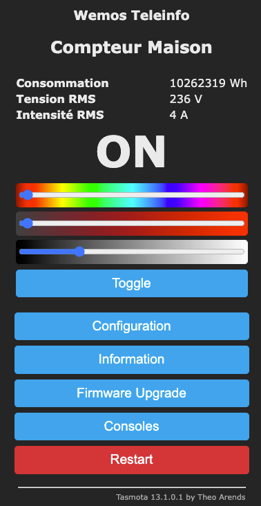

            et voila le résultat
            Facile non ?

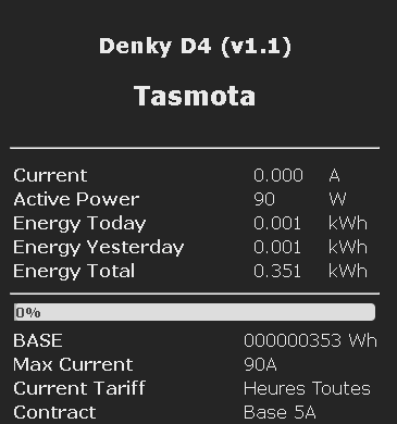

                    Et sinon parfois Active Power remonte bien les infos :
                    08:39:18.946 MQT: tele/tasmota_F5BD54/SENSOR = {"Time":"2023-10-31T08:39:18","ENERGY":{"TotalStartTime":"2023-10-21T19:40:23","Total":0.351,"Yesterday":0.001,"Today":0.001,"Period":0,"Power":90,"Current":0.000,"Load":0},"TIC":{"ADCO":"022064982940","OPTARIF":"BASE","ISOUSC":5,"BASE":353,"PTEC":"TH..","IINST":0,"IMAX":90,"PAPP":90,"HHPHC":"A","MOTDETAT":0}}
                    08:44:18.930 MQT: tele/tasmota_F5BD54/STATE = {"Time":"2023-10-31T08:44:18","Uptime":"1T12:48:49","UptimeSec":132529,"Heap":131,"SleepMode":"Dynamic","Sleep":10,"LoadAvg":99,"MqttCount":1,"Berry":{"HeapUsed":3,"Objects":39},"POWER":"ON","Dimmer":64,"Color":"3956A3","HSBColor":"224,65,64","Channel":[22,34,64],"Scheme":0,"Width":1,"Fade":"OFF","Speed":1,"LedTable":"ON","Wifi":{"AP":1,"SSId":"garage","BSSId":"68:3F:7D:59:23:50","Channel":6,"Mode":"11n","RSSI":100,"Signal":-44,"LinkCount":1,"Downtime":"0T00:00:03"}}
                    08:44:18.942 MQT: tele/tasmota_F5BD54/SENSOR = {"Time":"2023-10-31T08:44:18","ENERGY":{"TotalStartTime":"2023-10-21T19:40:23","Total":0.351,"Yesterday":0.001,"Today":0.001,"Period":0,"Power":90,"Current":0.000,"Load":0},"TIC":{"ADCO":"022064982940","OPTARIF":"BASE","ISOUSC":5,"BASE":353,"PTEC":"TH..","IINST":0,"IMAX":90,"PAPP":90,"HHPHC":"A","MOTDETAT":0}}
