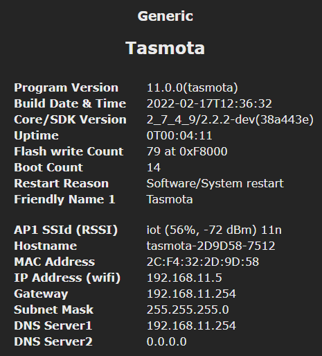

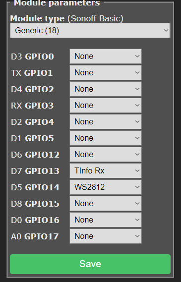

      J'ai reçu le mien ce matin, j'ai soudé les pins et ai branché le tout (ancien compteur). Je vois mes infos qui s'affichent mais certaines sont manquantes et d'autres erronées :

      00:00:00.001 HDW: ESP8266EX
      00:00:00.050 CFG: Loaded from flash at FA, Count 85
      00:00:00.055 QPC: Count 1
      00:00:00.096 Project tasmota - Tasmota Version 11.0.0(tasmota)-2_7_4_9(2022-02-17T12:36:32)
      00:00:00.097 TIC: RX on GPIO13, baudrate 1200
      00:00:00.701 SNS: Hardware Serial
      00:00:00.702 TIC: using hardware serial
      00:00:01.233 WIF: Connecting to AP1 iot Channel 13 BSSId 70:10:6F:F0:24:51 in mode 11n as tasmota-2D9D58-7512...
      00:00:02.502 WIF: Connected
      13:51:47.104 HTP: Web server active on tasmota-2D9D58-7512 with IP address 192.168.11.5
      13:51:48.754 RSL: INFO1 = {"Info1":{"Module":"Generic","Version":"11.0.0(tasmota)","FallbackTopic":"cmnd/DVES_2D9D58_fb/","GroupTopic":"cmnd/tasmotas/"}}
      13:51:48.756 RSL: INFO2 = {"Info2":{"WebServerMode":"Admin","Hostname":"tasmota-2D9D58-7512","IPAddress":"192.168.11.5"}}
      13:51:48.758 RSL: INFO3 = {"Info3":{"RestartReason":"Software/System restart","BootCount":16}}
      13:51:48.759 RSL: RESULT = {"POWER":"OFF"}
      13:51:48.761 RSL: POWER = OFF
      13:51:48.769 TIC: Total counter updated to 0 Wh
      13:51:48.770 TIC: Total counter updated to 125336755 Wh
      13:51:51.683 QPC: Reset
      13:51:51.751 TIC: Total counter updated to 125336756 Wh
      13:51:53.642 RSL: STATE = {"Time":"2022-02-17T13:51:53","Uptime":"0T00:00:10","UptimeSec":10,"Heap":25,"SleepMode":"Dynamic","Sleep":50,"LoadAvg":19,"MqttCount":0,"POWER":"OFF","Dimmer":0,"Color":"000000","HSBColor":"110,72,0","Channel":[0,0,0],"Scheme":0,"Width":1,"Fade":"OFF","Speed":1,"LedTable":"ON","Wifi":{"AP":1,"SSId":"iot","BSSId":"70:10:6F:F0:24:51","Channel":13,"Mode":"11n","RSSI":50,"Signal":-75,"LinkCount":1,"Downtime":"0T00:00:03"}}
      13:51:53.652 RSL: SENSOR = {"Time":"2022-02-17T13:51:53","ENERGY":{"TotalStartTime":"2022-02-17T00:00:00","Total":-21474.641,"Yesterday":0.000,"Today":0.195,"Period": 0,"Power": 0,"Current":2.000,"Load":6},"TIC":{"K5IMAX":33,"HHPHC":"D","MOTDETAT":0,"ADCO":"039601358856","OPTARIF":"HC..","ISOUSC":30,"HCHC":85374538,"HCHP":39962218,"PTEC":"HP..","IINST":2,"IMAX":33}}
      13:52:04.503 TIC: Total counter updated to 125336757 Wh
      13:53:53.998 CMD: energyconfig
      13:53:53.002 TIC: Settings Mode:historique, RX:GPIO13, EN:None, Raw:noraw, Skip:0, Limit:0
      13:53:53.004 RSL: RESULT = {"EnergyConfig":"Done"}
