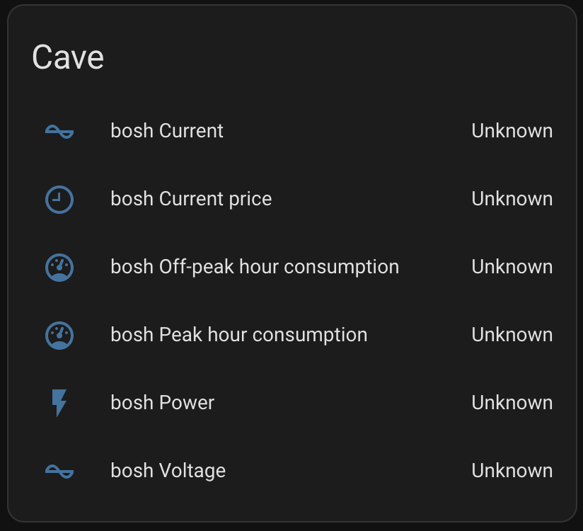

      Everything compiles and installs correctly but it seems like no data is being received from teleinfo:
      I've checked that my meter is set to "Historical mode" and the baud rate is correct.
      I was not sure of which way round to connect the Linky to the Teleinfo shield, but I tried both ways and neither seems to work.
