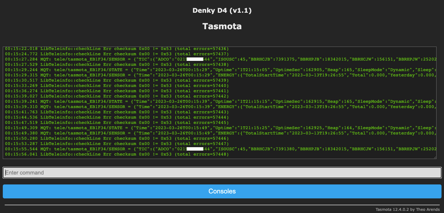

    • RE: Rubriques manquantes
      @Charles Voici les trames :
      12:15:29.301 MQT: tele/tasmota_EB1F34/STATE = {"Time":"2023-04-12T12:15:29","Uptime":"6T05:57:02","UptimeSec":539822,"Heap":161,"SleepMode":"Dynamic","Sleep":50,"LoadAvg":20,"MqttCount":10,"Berry":{"HeapUsed":7,"Objects":109},"POWER1":"OFF","Dimmer":100,"Color":"00FFED","HSBColor":"176,100,100","Channel":[0,100,93],"Scheme":0,"Width":1,"Fade":"OFF","Speed":1,"LedTable":"ON","Wifi":{"AP":1,"SSId":"xxxxxxx","BSSId":"xxxxxx","Channel":11,"Mode":"11n","RSSI":100,"Signal":-30,"LinkCount":1,"Downtime":"0T00:01:47"}}
      12:15:29.324 MQT: tele/tasmota_EB1F34/SENSOR = {"Time":"2023-04-12T12:15:29","ENERGY":{"TotalStartTime":"2023-03-13T19:26:55","Total":0.000,"Yesterday":0.000,"Today":0.000,"Period":0,"Power":0,"Current":2.000,"Load":4},"TIC":{"ADCO":"xxxxxx","ISOUSC":45,"BBRHCJB":7450836,"BBRHPJB":18409182,"BBRHCJW":174214,"BBRHPJW":270655,"BBRHCJR":97931,"BBRHPJR":162452,"PTEC":"HPJB","DEMAIN":"----","IINST":2,"IMAX":90,"PAPP":0,"HHPHC":"A","MOTDETAT":0}}
      12:15:30.611 MQT: tele/tasmota_EB1F34/SENSOR = {"TIC":{"ADCO":"xxxxxx","ISOUSC":45,"BBRHCJB":7450836,"BBRHPJB":18409182,"BBRHCJW":174214,"BBRHPJW":270655,"BBRHCJR":97931,"BBRHPJR":162452,"PTEC":"HPJB","DEMAIN":"----","IINST":2,"IMAX":90,"PAPP":0,"HHPHC":"A","MOTDETAT":0}}

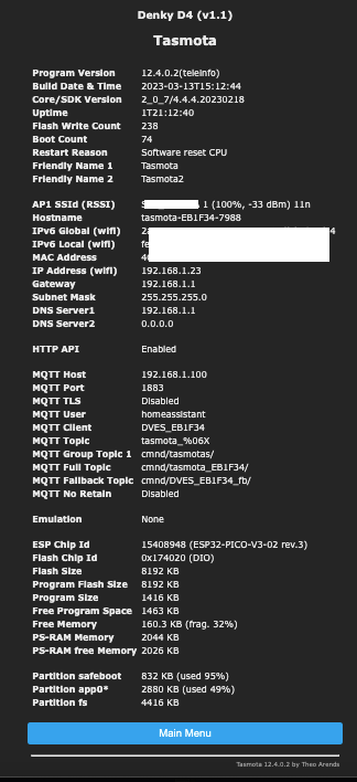

    • Rubriques manquantes
      le module fonctionne correctement et me remonte bien ma consommation, mais les rubriques “Energy Today”, “Energy Yesterday” et “Energy Total” ne s’incrémentent pas du tout.
      J’ai aussi pas mal d’erreurs de checksum, mais c’est peut-être normal.
      Pouvez-vous m’aider, svp ?
      Cordialement,
      Ben
      Screenshot 2023-03-26 at 00.11.36.png Screenshot 2023-03-26 at 00.13.19.png Screenshot 2023-03-26 at 00.16.20.png
