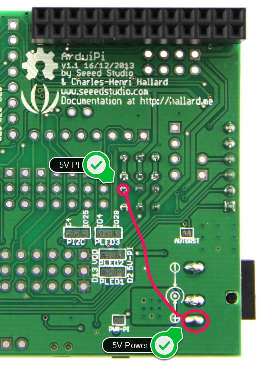

        Has anyone tried to power the Pi from the ArduiPi?
        Is it possible?
        In my case it would be more interesting to have it this way from a connector point of view. The power will surely be strong enough as provided by a computer power unit given at 12A on 5v.
          @schoopy
          I looked at the schematics and it not possible "as is" but you can do it of course.
          If your power is 5V I suggest you bypass the ArduiPi Regulator and send 5V to Pi using a wire like as follow
