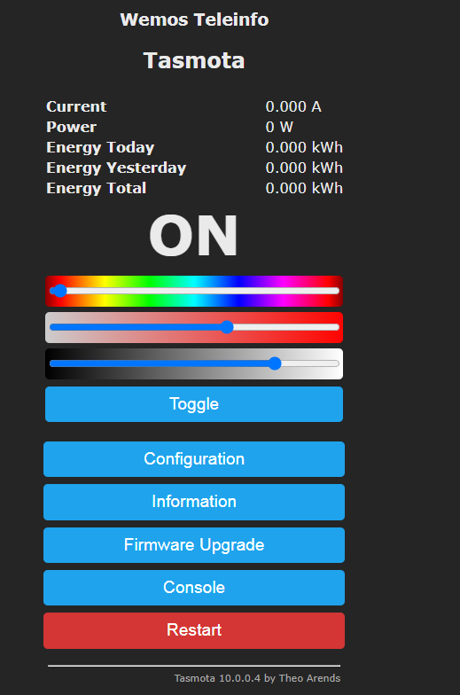

                  I also tried making tasmota teleinfo as you described previously. I applied the template
                  {"NAME":"Wemos Teleinfo","GPIO":[1,1,1,1,640,608,1,1,1,5152,1376,1,1,1],"FLAG":0,"BASE":18}
                  (The one that you wrote in previous message is for esp32)
                  and put in two command into console.
                  14:09:57.984 CMD: EnergyConfig Changed
                  14:09:57.987 TIC: Raw to 'changed'
                  14:09:57.991 MQT: tic/RESULT = {"EnergyConfig":"Done"}
                  I can change the RGB led via the web interface,
                  I see that it is connected to mqtt but is sends no data to specified topic. and the web interface show this 😥
                  Probably resoldering the shield to esp32 board is the simplest solution.

                    @dmitry-korzhenevskiy if you don't have other value on tasmota web interface, this mean that teleinfo was not detected, are you sure (check in template menu) that Tinfo RX pin is on GPIO13 (template should have set it) ?
                    Could you post a picture of your WeMos and Shield Assembly?
                    Just flashed WeMos D1 Mini from scratch (full flash erase before) with latest tasmota. Reset, connected to AP, then connected tasmota to my WiFi and applied template you mention earlier, that's it.
                    Are you sure of your connexion on teleinfo and connectors correctly soldered on WeMos Teleinfo Shield? Check Also on smartmeter connexion I already had some issue due to bad connectivity.
                    Dmitry KorzhenevskiyD 1 Reply Last reply Reply Quote
                    • Dmitry KorzhenevskiyD Offline
                      Dmitry Korzhenevskiy @Charles
                      @charles I am sure the connection is ok you don't need to see the assembly. because it worked 1 hour before with serial.swap and I did not change anything apart from the software. The red light that indicated the TIC serial activity is flashing as before.

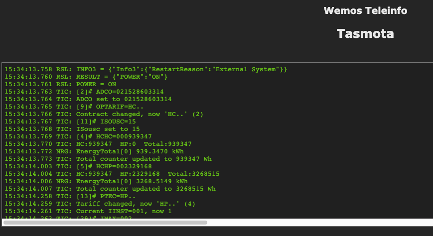

                        @dmitry-korzhenevskiy With Tasmota it should works right out of the box. Did you configured the teleinfo mode to your mode?
                        I mean with option EnergyConfig Historique (1200 this is the default) or EnergyConfig Standard (Linky standard 9600)?
                        With ESP32 we'll have more debug info, for now you can setup weblog to Full Debug an look in the console on boot and see interesting things

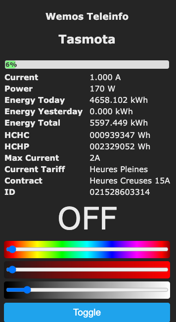

                          I think I found the solution. I needed to enter two lines
                          EnergyConfig full
                          Now the updates are consistent.
                          Now I have PAPP update every 1.4 s.
                          Tasmota works much better than custom arduino program using the library. Even on softserial with esp8266.
                          Thanks
                          The problem solved.
